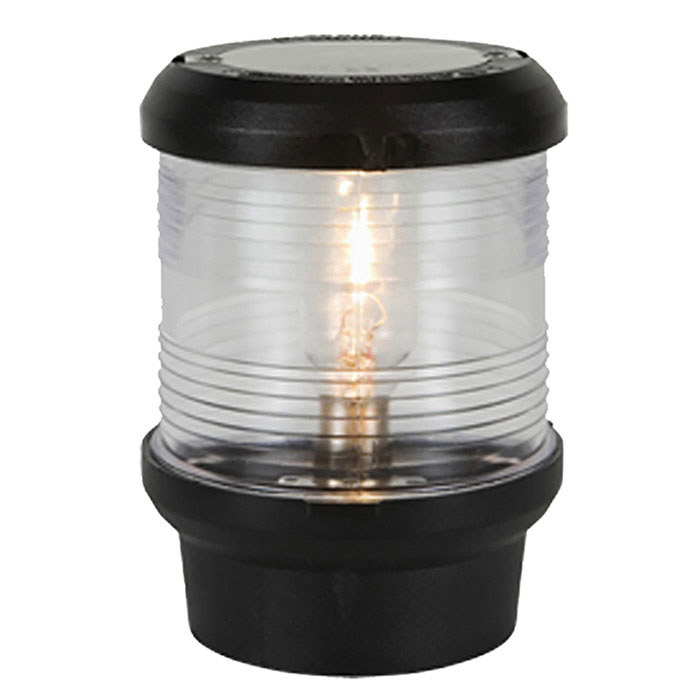

Im looking for a one-shot light up top the mast that performs both navigational and anchor light functions ...so far have just found this at defender for $140....anyone know of something cheaper??
Why? Use the stock Mac system for navigation, and add a separate top of the mast all round for the anshor function. [www.defender.com/product.jsp?path=-1|65 ... 9&id=89437] $40 for the series 40, less for the series 20. Sorry about the long url; I've never been successful using BBCodes with Defender urls.
