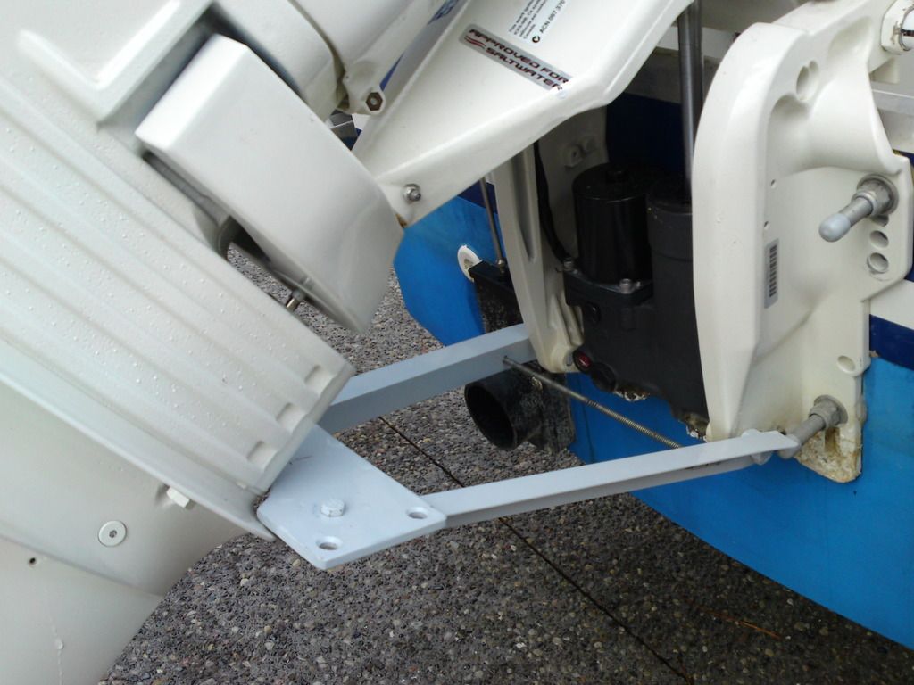

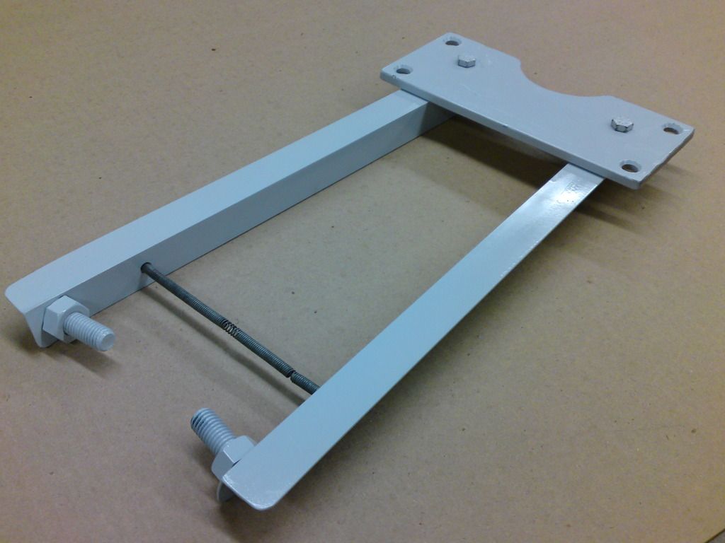

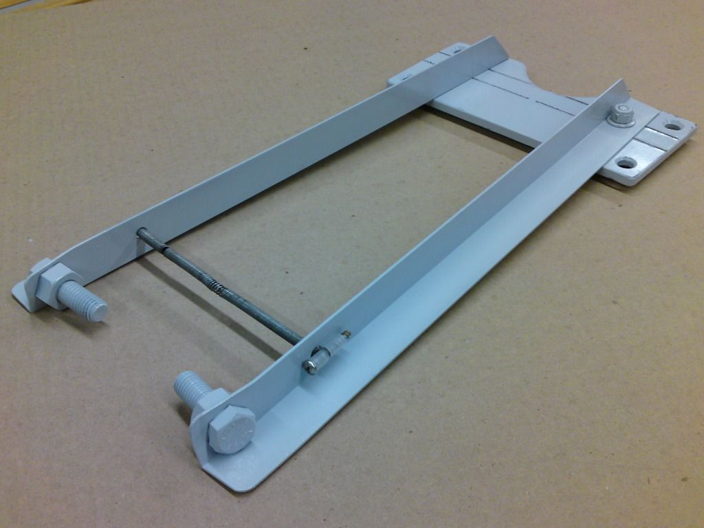

Motor support bracket for trailering, bodged from 1"X 1/16" aluminum angle, a piece of scrap 1/4" Spaulding fibre (so it won't rust or damage the paint on the motor), a spring (I forget where that came from), and a couple of 1/2" bolts and nuts.
The inward facing bolts are bent so as to be parallel when they enter the bottom holes in the motor mounts. With the motor up, the thing gets sprung open and snapped into the holes in the mounts, then the motor is let down onto it. When the motor is lifted up far enough again, it disengages the bracket which drops down out of the way, so the motor can then be lowered, which I do upon arrival at the storage facility.
For seasonal storage the batteries are out (I have those on a quick-release bracket too, BTW), so the red relief screw must be opened, and the motor is raised or lowered by hand. Its movement is still damped by the hydraulics, so if you just let go it takes a few seconds to drop down completely. This also damps any bouncing when trailering over potholes, which might otherwise allow it to release and drop down unintentionally. (I followed the boat once when someone else was driving the tow vehicle, so I got a chance to see this and other things first-hand). The extra holes were for tie downs for long trips, but I didn't know they would not be necessary at the time I made the bracket.

Ps. (I checked) The E-Tec manual warns that it may cause damage to use the tilt lock for trailering (again, I have not seen otherwise for other motors I've owned over the last several decades). If road clearance requires tilting the motor, the manual recommends the use of an "accessory trailering bracket".

That locking lever on the smaller ETECs is not for holding the motor up when trailering and yes it warns against doing that in the manual. Although I did not know this until yesterday and have always used it to trailer with. :cry:
I put my boat in at the local Mercury dealer to have a fuel issue looked at three months ago on my Etec, and have not looked at the boat since bringing it home after that. Yesterday I was getting it ready for an upcoming trip and noticed that my locking lever is no longer there - broken off. Only two possibilities, the Mercury dealer snapped them off and didn't tell me about it, or it failed in the half mile journey from the Marina to here...
Thanks Seahouse, Reckon I'll fashion something like what you have done there!
