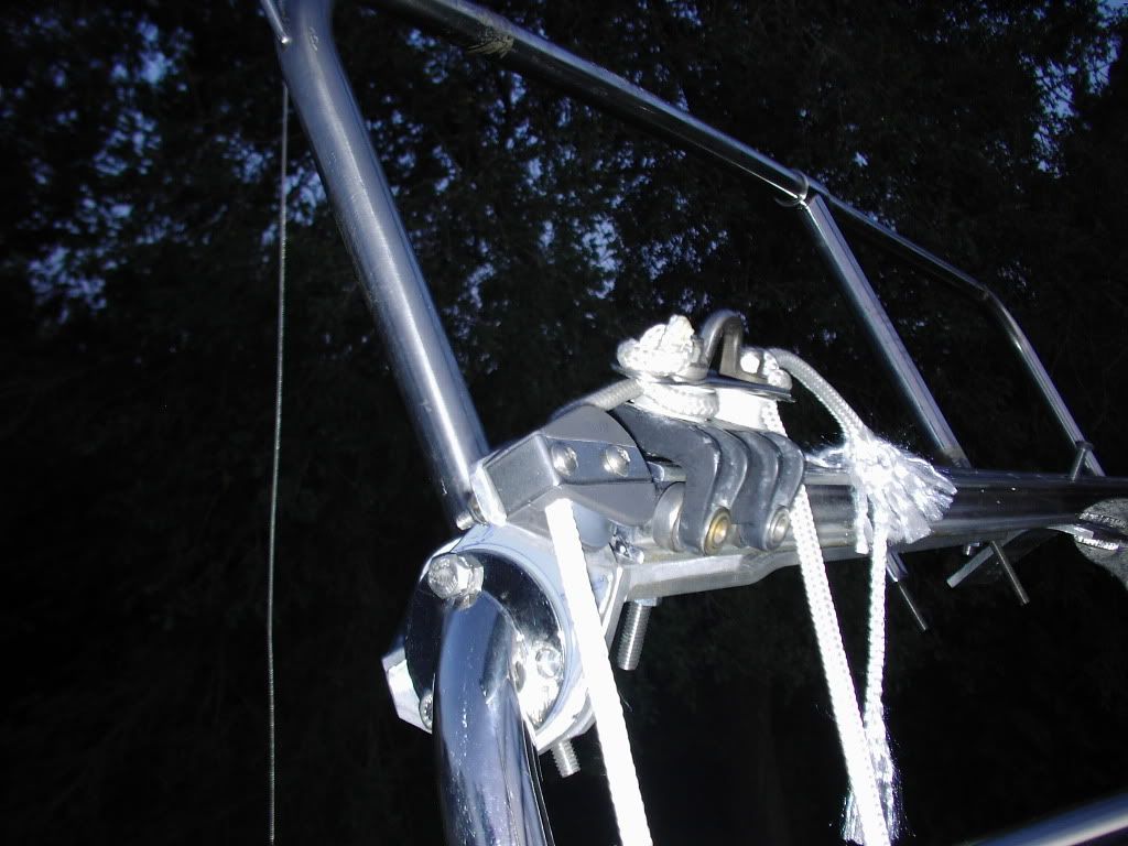

So thinking about this there's no way you could have a back stay (it would effect the swing) or tighten a backstay with and swinging mast (it would bend the mast sideways'ish)

Nope I resolved that issue !
http://vid844.photobucket.com/albums/ab ... 0011-1.mp4
http://i844.photobucket.com/albums/ab1/ ... 010021.jpg
these r some old vid during the fabricating process
masthead swivel mount
http://i844.photobucket.com/albums/ab1/ ... 010014.jpg

Well done for solving that .... I guess you need it with all those furlers too.Highlander wrote:Nope I resolved that issue !
You're very brave with all your project .... But the complexity of your setup at the back makes my head spin
All the bars must weigh a fair amount. Have you noticed any difference in the way she handles?
