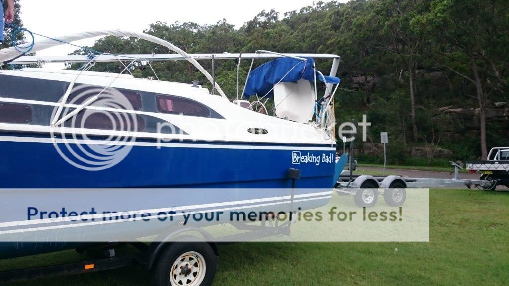

BTW the deck sustained minimum damaged because the top 10 feet bent at right angle and hit the ground before the rest of the mast hit the deck... The name of my Mac takes on a completely new meaning in this photo lol!
