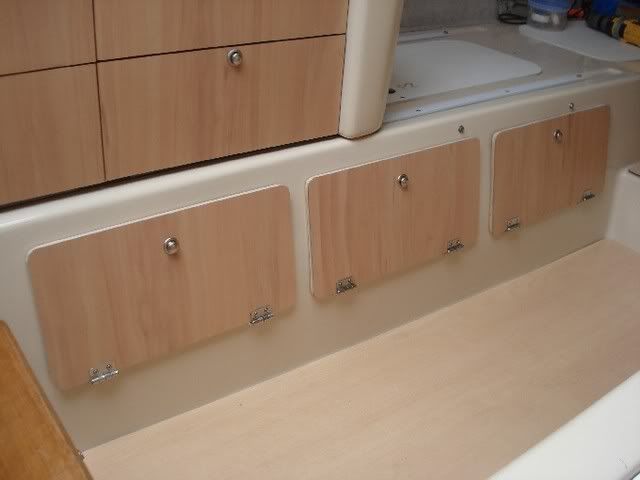

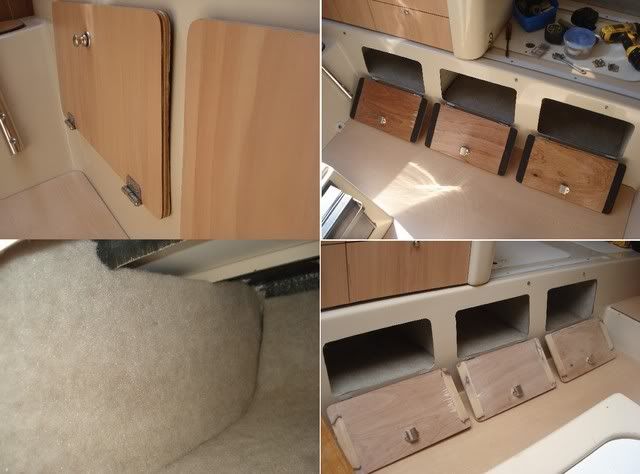

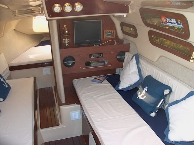

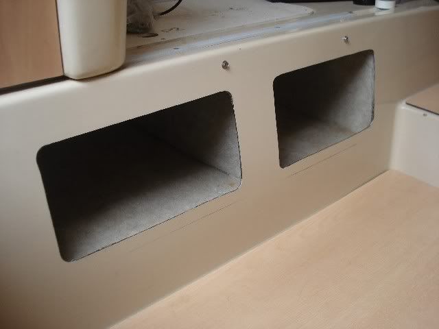

I have saved a lot of photos from the mods page. These photos are not of The Yam and I am sorry I don't know who's boat it is. They are lovely mods though, I wish I had the talent to do this.

That is quite impressive. The mod pics do not even look the inside of a 26M. Some sailors are skilled with making upgrades.
Thanks for the suggestions too.

It's a long story, but my brand new 26M arrived with several holes in the side of the storage compartment under the galley that it wasn't supposed to have. Now I'm looking for a way to hide them.
I went out and bought a couple of 13in x 23in Sure Seal Hatches from West Marine (Manufacturer Part #T-H MARINE HAT-1324-2-DP, West Marine #4581567). What I'm thinking of doing is sort of similar to the mod in the pictures posted on June 12 by David Mellon. I know he said that unfortunately he doesn't know who did that mod.

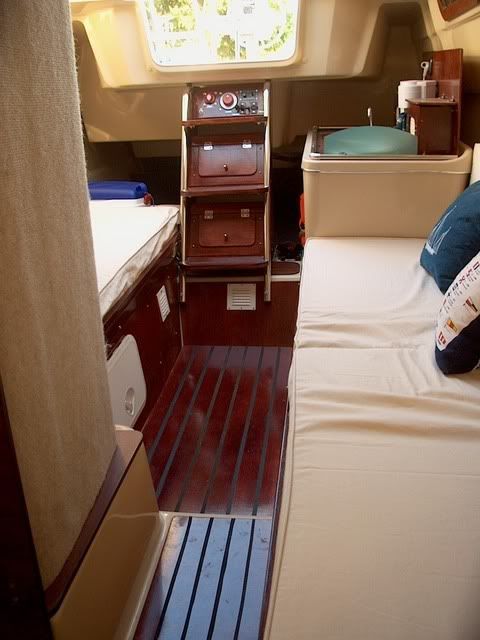

The light colour trim is my boat when the mods section is back up and running search Jack Sparrow/storage there are 2 parts to this mod.
Jack Sparrow
