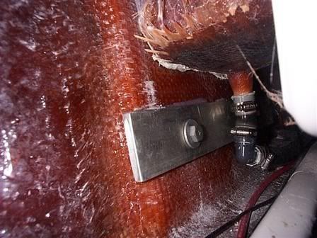

Dave, I don't really think I'm wrong on this (?) ...DaveB wrote: . . . your going to depleat all strength in a U channel bar ...you have exceded the purpose. All you have is a backing plate with top/bottom plates going accross with no structual forces because of the size of Hole cut in , What you have is for and aft strength and no lateral.
The large hole (for port transom thruhull, pictured earlier) doesn't really impair the strength of the channel too much. The top/bottom rails are still providing real rigidity to the entire width of the transom. However, that notch they cut into the top rail (motorwell drain notch) was a mistake. The correct approach would have moved that motorwell drain forward (and enlarged it), leaving the top rail unmodified.
Nonetheless, after ten years in service, my transom has zero-evidence of undue stress. I remain convinced that my full-span C-channel bar (about 54" long) is still way better than the alternative. Photo below shows Billy's inner transom plate, a qtr-inch flat aluminum bar, spanning only the distance across the motor mount. I think Mark used a similar method, and reported later that his transom failed after the outboard leg struck a submerged object.
The full-span C-channel simply MUST ADD lots more strength than a flat AL plate, and it's full-span, Rudder-to-Rudder~!
If I was going to mount a 90+, I think I'd be changing the motorwell drain, then using exactly the same C-channel.
See my Transom Album.
OnEdit: corrections per Billy's comments below.
Billy's Inner Transom Plate at Stbd Engine bolt
Full-Span C-channel, rudder-to-rudder (engine bolts hidden behind the motorwell)

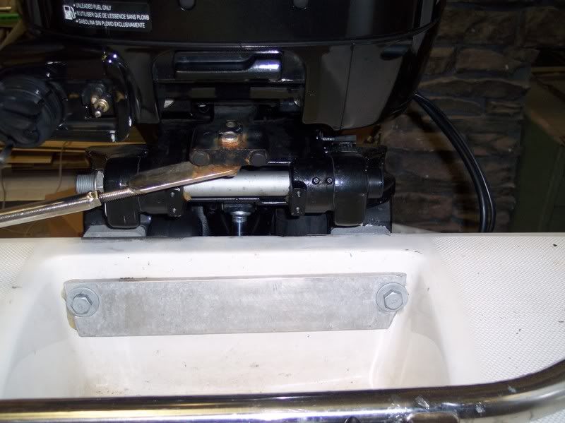

For what it is worth, here is a pic of the plate I installed in the inside of my o/b motor well....
I installed the same bar as seen above on the inside of the aft berth.
My motor is 380 dry and prob 420 all in.

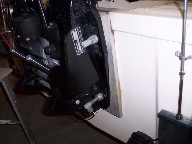

OK, guys, here's what has worked for me the past 6 years with no signs of any failures. I used 2 aluminum plates 1/2"x4"x13.5" stood vertically. The top of the plates were notched to fit the lip of the transom. I wanted to create a bigger footprint for the engine mount to push against. On top of the plates I mounted transom wedges. I strongly suggest these along with the reinforcements. This will give the engine a better angle of attack in keeping the bow down on "take off" as it tucks the prop a little more under the transom.
Inside the well, i used 1/4"x2.5"x14" aluminum flat bar. This piece needs to be shaped with the curvature of the well. Not just the ends but the entire piece will need a slight bend. I actually overbent the bar so the contact would be more equal. (This is where Mark's installer did not follow directions and had bad results.) The purpose of this bar is to spread the load when extreme reverse is required. BTDT.
I didn't have time to photo the inside today, but it consist of another aluminum flat bar running horizontally. Just saw it in upper post, Thanks Frank. That was mine, not Mark's and it hasn't failed.
So basically I have 2 bars mounted vertically & 2 bars mounted horizontally, sandwiching the transom. Also used silicone around the bolts (not 5200). One day it may need to come off. Hopefully this is what Tony & AKCoastie wanted in their emails. If not, email me again with any questions. Good Luck. And Tony I know you're going to enjoy that engine. BTW, Mark's boat is now in NC. Talked with the owners last year.
