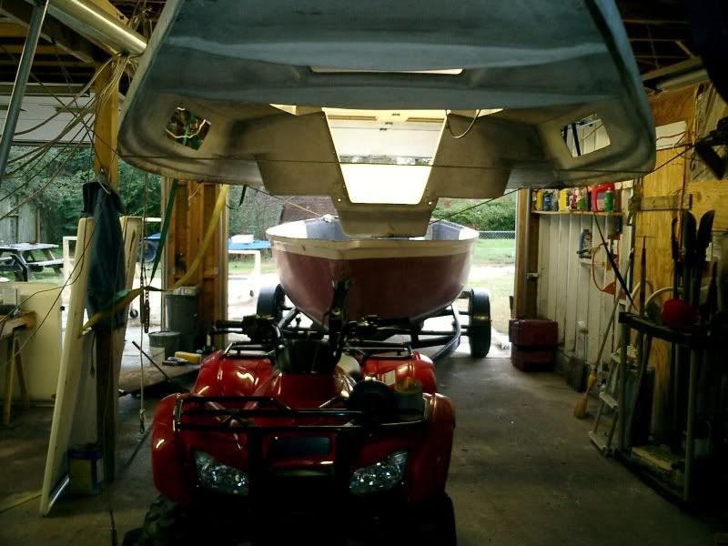

I lifted the deck off the hull yesterday by straping it to the roof in the garage. With it done, I kinda whish I had done it sooner. It Would have made everything else I have done easer. At any rate in just a few hours I was able to clean the dirt and cauck from the top of the hull, wash out side hull with acitone and wet sand. I have a few small areas to fill but other then that the hull is ready for paint.
The deck is also going to be a lot easer to work on now. The only problem is I need to get it in a position where I can work on it. Right now its still strapped to the celling on my garage. My plan is to finish the repairs to the deck and then mount all the hardware before setting it back on the hull. I will post pictures when I get a chance.

Here is the deck being lifted.
Here I am backing the hull out from under the deck

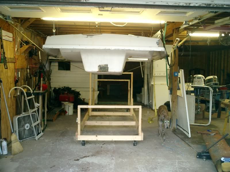

I made a quick stand to set the deck down on so I could work on it.
In this last pic there is a bare patch of fiberglass. Looks like something was removed. Any ideas what was there?

I am really impress by the extend of the work you are doing. If you have a chance, could you make some picture shot on the inside of the hull (detail of the keel boss).
For the extra patch, Is that correspond to the drain area?!? On my MAC 25, I have the water drain for the deck at this location.
