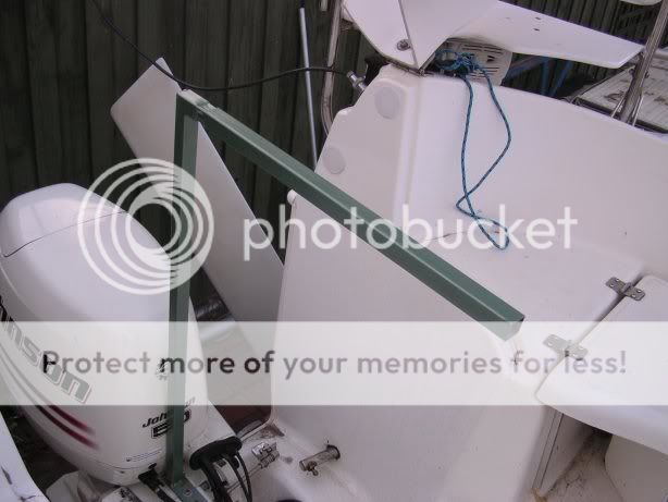

I finally managed to get some photo's of my emergency tiller setup. Essentially it is made up of a couple of pre-pressed and welded 1" pipe from Bunnings. Bunnings sell these bits as build your self gate pieces. I cut one end off and welded it to a piece of flat steel and bolted that to the motor.
http://i728.photobucket.com/albums/ww28 ... iller3.jpg

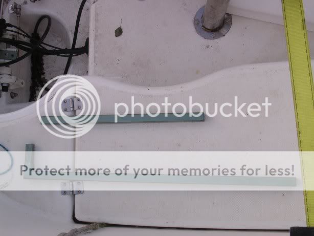

The pieces that made up the tiller can be pulled apart and I currently store them below decks. However I plan to make up some brackets to fit them underneath the skippers seat.
http://i728.photobucket.com/albums/ww28 ... iller2.jpg
When the pieces are put together and fitted to the motor it makes a very effective tiller. I have tried mine and it works well.
As far as using it for sailing is concerned, it's not a fantastic solution, but it would work in light to moderate winds (asuming that the rudders have been raised). I doubt that it would work in strong winds, but then again if I broke my steering in strong winds my desire to sail (and I suspect the admiral's) would dwindle rapidly.

Brian,
Great idea. thanks
Do the press fit elements hold tight enough to exert reasonable leverage especially on the tiller arm. I have used that stuff from Bunnings before and was surprised that it would hold but apparently in your test it it did. Just wonder whether you would need some kind of locking arrangement eg. SS bolt and wingnut through it?

David,
the bits I used fit very firm and in the couple of trials that I have put them together for, it took a fair amount of work to get them apart again. If they were a loose fit, I'd be more in favour of smacking the edge to take it off square and ensure a tight fit. I'm not really in favour of adding more bits (bolt, clip etc), as the more complex a design the more likely of failure. Seeing that this is designed (flash word for banged together) for emergency use, I'll just keep with the KISS principle.
It does work, and it works well.
Brian

KISS is a good principle whenever possible so glad to hear that they hold fairly well. good easy mod that when you have it you probably will not need it but when you don't Murphy's law will always prevail.
Thanks Brian
