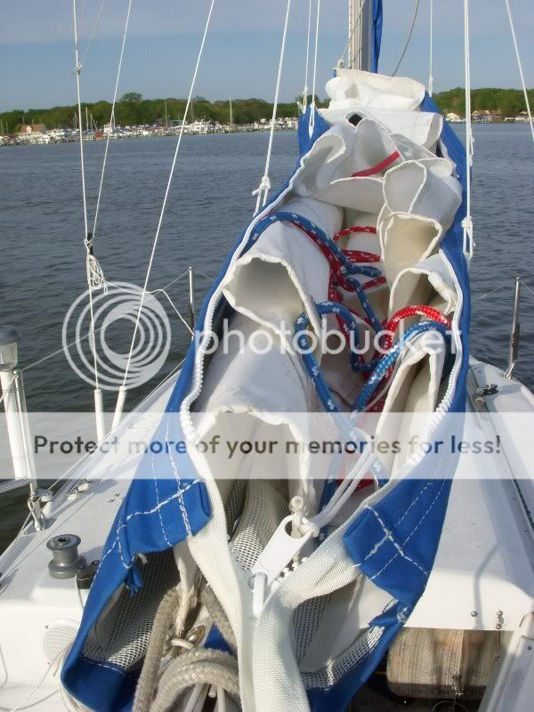

I did a search on WestMarine, Defender, and Sailrite. They have LJ systems ranging from $160 to $250 for Mac sized boats. But these are just "simple" LJ systems versus the Cradle Cover style that Rick linked to.
I have one of these "simple" systems and it works great for me. Very necessary IMHO since I like to singlehand and can drop the main from the cockpit and not have to get up on deck. The LJ system catches the sail and I can just motor away. Don't even have to tie it down...but I do if I am going to motor fast for more than a few minutes.
I believe the references to the grommets in the main is for another system...can't think of the name but several guys on this board have it. The "simple" LJ system does not need any grommets. You need to do nothing to the sail. You just need to mount a few blocks and install some line.
Don't remember which brand my system was as it came with the boat. But I modified it quite a bit and it is pretty much homemade now. I made it "quick release" so that I can take the LJ system down quickly/easily when I want to put the sail cover on...or my future boom tent.
Here is picture of my lines:
And here is a short video of my LJ system in action. Notice I never leave the cockpit and the sail flakes into the LJ system very nicely:

Jim, that was awesome! Does your mainsail come down like that every time? Do you use a downhaul line or does it just drop like that? Love it! Mine always requires help to manualy bring it down.
Leon
Leon

Leon,
Yes, every time it comes down like that. But, yes, I also have a "haul down" (as opposed to the rigging feature that already has the name "down haul"). My "haul down" is just the opposite end of my halyard. The line is over 70' long...one end tied to the top of the head board and run up over the block at the top of the mast (the "halyard" part) and the other end is tied to the top most sail slug and is used to pull the sail down. The line runs through a series of blocks back to the cockpit.
I didn't design or build this. It was designed/installed by the original owner (an ex-pat Brit living in Tarpon Springs, FL). However, I redid the Lazy Jack system to make it "quick release" and easier/more convenient to use.
