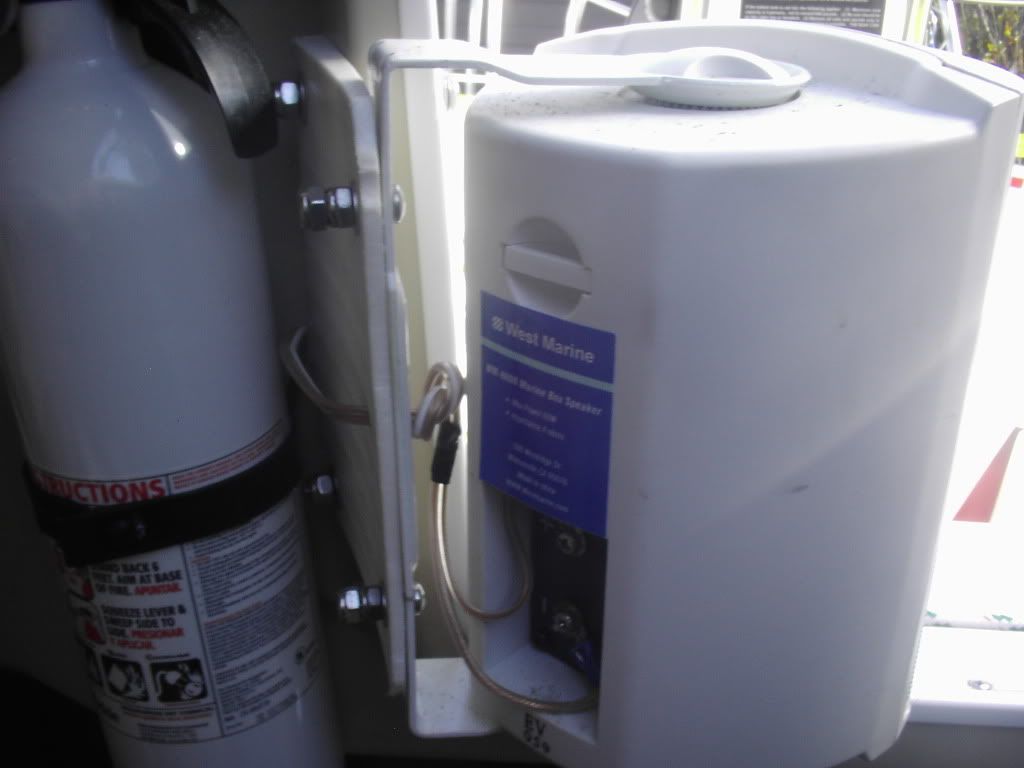

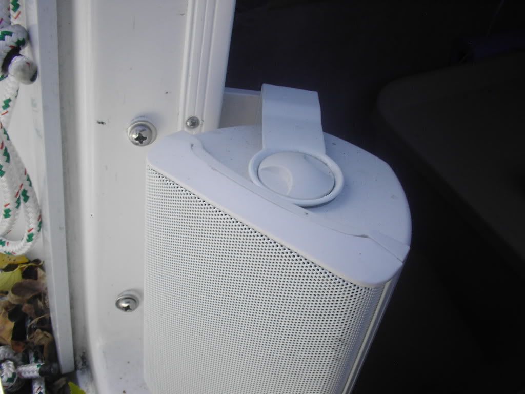

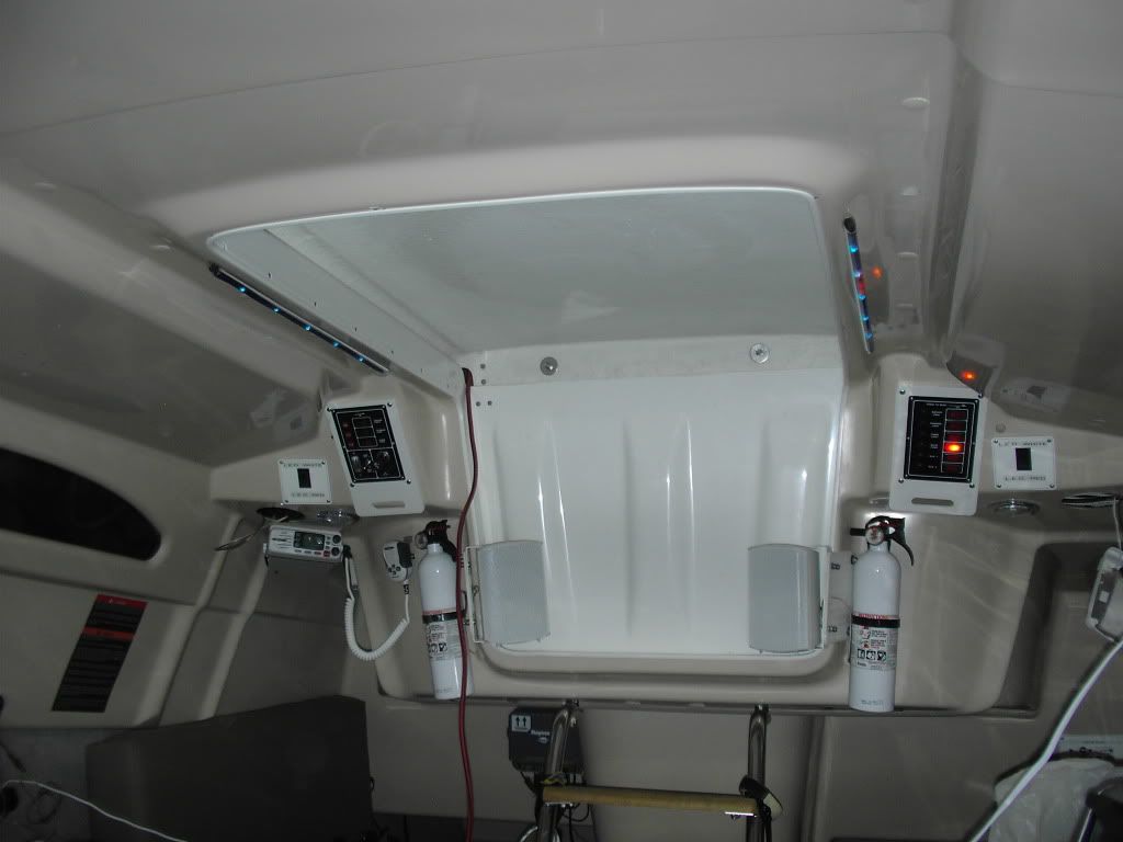

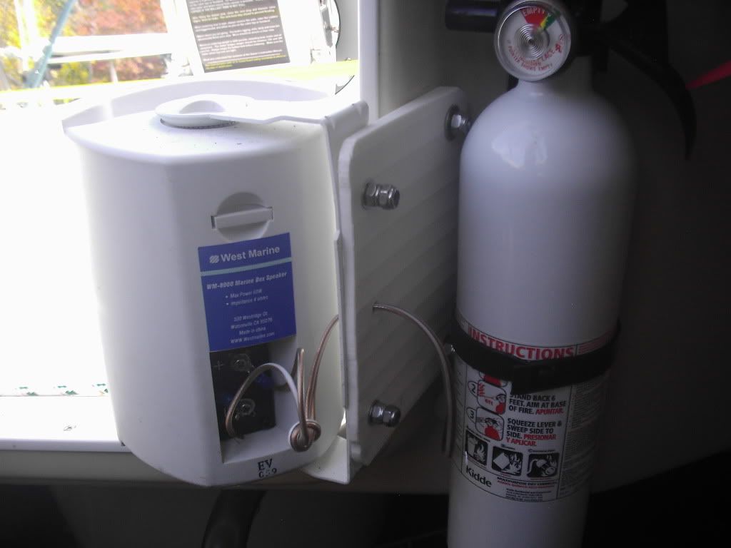

here's my set up my radio
http://i844.photobucket.com/albums/ab1/ ... 010006.jpg
my rear cabin swing out to cockpit speakers
http://i844.photobucket.com/albums/ab1/ ... 010001.jpg
their mounted on wedge shaped plastic boards so as if you bang into or lean against them they will flex backwards so as you do not hurt yourself & spring back into their original possition you can swing them around so as they point into the cockpit for a great sound
http://i844.photobucket.com/albums/ab1/ ... 010039.jpg
http://i844.photobucket.com/albums/ab1/ ... 010040.jpg
http://i844.photobucket.com/albums/ab1/ ... 010041.jpg
http://i844.photobucket.com/albums/ab1/ ... 010042.jpg

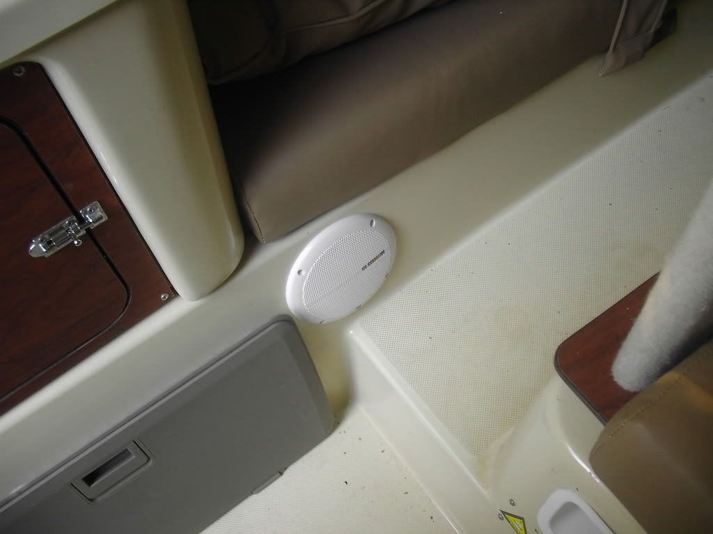

Here's where I mounted our stereo speakers in our 26M:
#1 is on the verticle panel under the forward part of the starboard dinette table.
#2 is directly across on the port side.
Our daughter is an audio technician and she approved of this arrangement

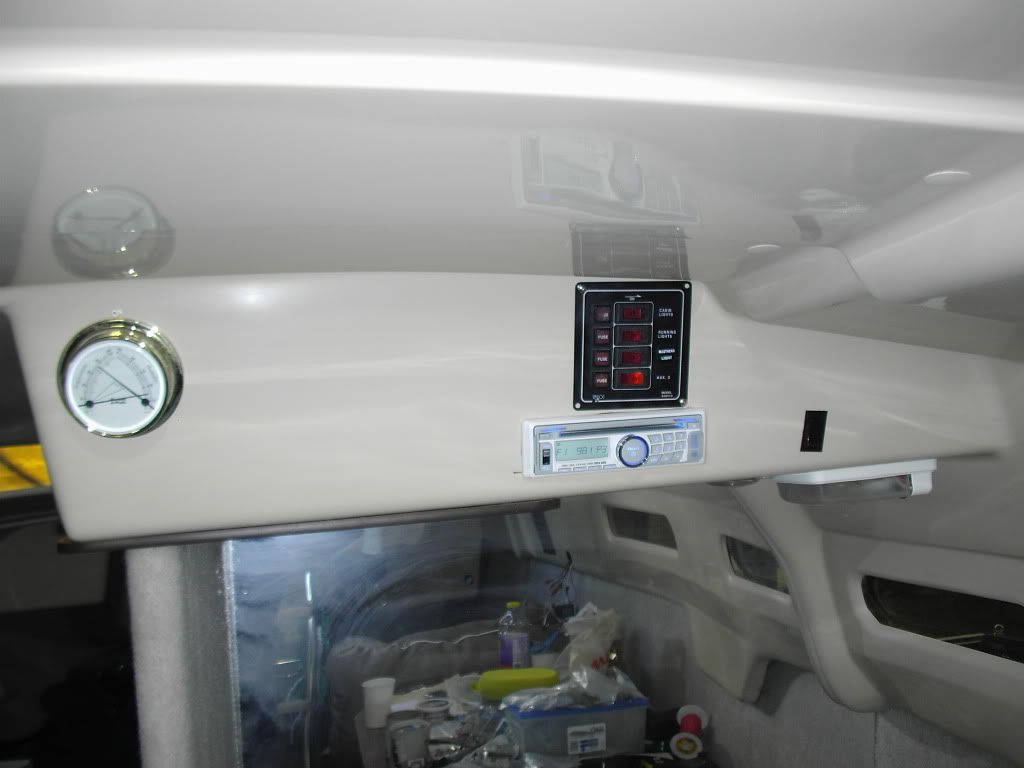

I put the radio/cd and the speakers in the area above the big mirror, lots of space, allowing radio, speakers, and antenna to be contained in one place.
Just bite the bullet and cut the holes needed, but use the fancy jig saw with a steerable blade. You'll need it in such tight quarters.
Switched 12v power is available there also, either from the table light or the mast light plug, all in the same void.
Just cut the wires of your choice and tap the power for the radio and antenna, switched from the power center.
My unit came with a remote control that works great from the cockpit.
( A remote control for a car radio??? I don't get it for use in a car??? But it's great on the boat)
I also used a 12v powered dipole FM antenna streched out on the inboard side of the daggerboard trunk behind the little mirror there.
Works okay for AM also.
It's all semi cheap car stuff, but no problems at all in three years.
Granted, not much stereo separation, but I'm not to picky about such things for casual tunes or news.
Another down side is losing all of the station presets when I leave the boat for weeks at a time.
I turn off the power switches at the panel, killing the radio.
Small price in exchange for such an easy an power run IMHO.
