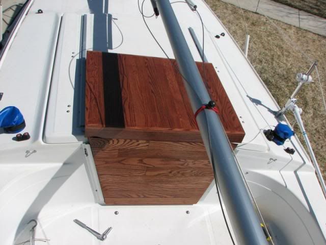

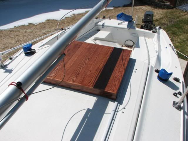

Re: Deck/Cabin parts, guidance? (Cabin Hatch) 90 26s
Post by Doug91mac26s »
How about making a new one all together out of wood, looks great!

Doug91mac26s
Posts: 113
Joined: Tue Jul 15, 2008 9:49 am
Location: Oceanside, CA
It sure is nice. I don't know who's boat it is, I want to say Beamreach, but I'm not sure. I just saved the pic to my scrap book, take a look. There's no order to the pic's they're all just thrown in there. http://s33.photobucket.com/albums/d64/d ... k/?start=0
What would make a mod like that even more cool, would be to put a little bit of an arch on it. But it's nice the way it is.
