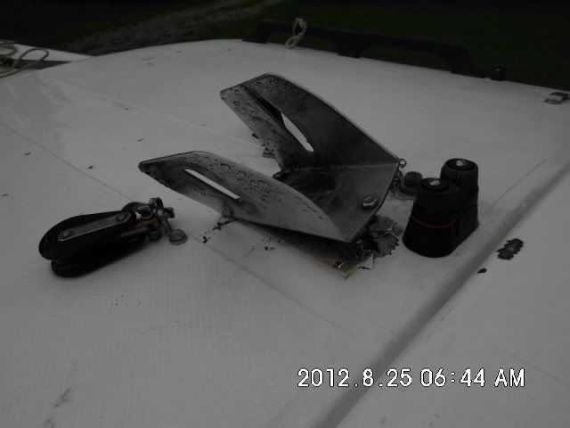

about 3/4s the way down the mast starts to come toward me on the port side....my son on the starboard side can't hold it...It begins to twist and comes right toward me... I caught it and there is no damage to the mast, but as it swung down and sideways it twisted the mast step, and pulled the rear bolt right through the roof....
Louis is real apologetic, will help me fix it.... It looks like I'll be doing a little glasswork. But he says its actually a blessing in disguise, as the mast step bolts don't even have washers underneath...he says there should be a plate, or at least large washers....
So would like opinions....he says we can hammer the step back to shape...I am not sure
Can I buy a new one? Are they expensive and where do I get one....I am not sure I am even calling it by the correct name....
I couldn't sleep last night, kept hearing the horrible tearing noise as the bolt pulled through....
I am sure I am not the only one that has done this....please help me feel better and tell me I haven't ruined the new boat....

The mast step is probably salvagable. I bent the one on my A23 years ago, which was similar with the vertical slot, and simply bent it back into shape. It doesn't do much when sailing, other than keeping the mast base from sliding out of place.
If you want a new one, Blue Water Yachts lists a replacement for $37. BWY p/n 3439-1V0. I don't know if it's identical, and the description is a little vague*, and there's no pic, but it's worth a phone call at least, if you don't want to try fixing what you have now.
You might also want to consider replacing it with the hinged type used on X and M boats.
While that mast step shouldn't be taking any real load under normal circumstances, it does have to resist a good bit of force when raising/lowering the mast, and especially if using a mast raising gin pole. The bolts should be backed up with a backing plate or large washers (not thin fender washers).
Oh, and do look into adding some babystays like the X and M boats, and many other have retrofitted, to prevent the mast from going over sideways in the future. I can, and often do, raise and lower the mast myself. No help. No broken parts. No injuries. No worries. 8)
*From the part listing - Notes: THIS MAST BASE IS APPROXIMATELY 4" TALL AND HAS A LONG VERTICAL SLOT IN EACH SIDE FOR THE MAST BASE BOLT . USED ON ALL KEELBOATS AS WELL AS A FEW M19S AND 26CS IN 1992 AND 1993. CAN BE UPGRADED TO NEWER HINGED STYLE MAST BASE BY USING PART #3438-1X0 ZND 3439-1X0.

We will definitely put a backing plate after I do the glass work... Hopefully I can repair it and the base will hide the repair...won't know until I get the actual baseplate off...
I am thinking that BECAUSE there was no backing plate, and the bolt tore through with no washer, leaving a very small hole, that It actually saved the boat from more damage....

You dont need to worry about backing plates, but you do need to repair the deck damage. All of the mast lad is compression onto the deck - you need to reglass an epoxy where the bolts pulled out imho

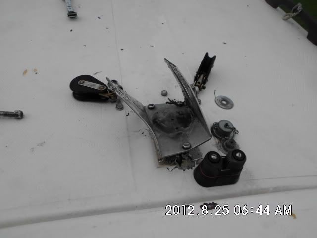

My Venture 23 was run over and dismasted at her mooring by a drunken power boater several years ago. You can see what happened to the mast step. I had an 8" square 3/16" aluminum backing plate under the deck so the bolts did not pull out. The step itself was pretty mangled but I straightened it out and have had no problems.

I am definitely going to fix the roof and re-glass/epoxy
the actual glass damage is not so bad because the bolt pulled through with no washer, so there was little fiberglass damage...
