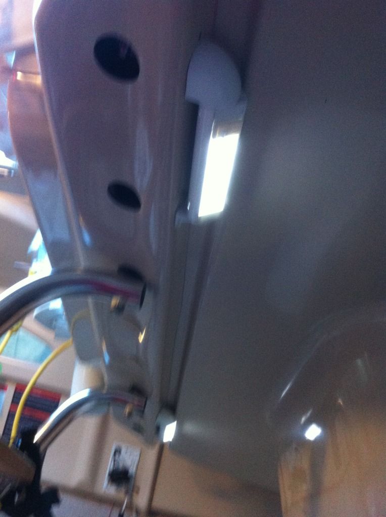

I re-did my 02 X a few years back and the one thing I recall is that you cannot use the old wires to pull the new. It looks like the factory ran the wiring before they assemblied the hull and liner. in my case some of the wires were taped together and then ran different paths to the same point
My bow and stern lights were the same as yours and mounted on the pullpit and stern rail. I was able to get the wiring up to the v-berth but no futher. On my 02 there was no way to remove the head liner and get the wiring any further. I ended up replacing the wire to that point and then spliced.

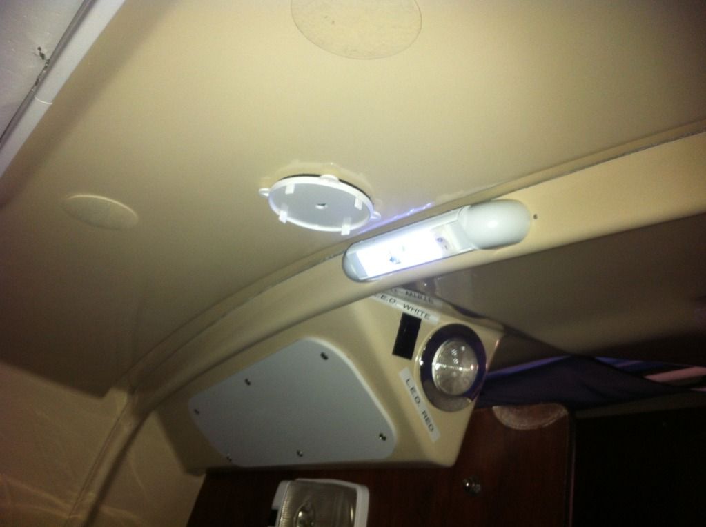

I haven't reallt rewired the whole boat. I stayed with the old wires that were in good shape. That's all the nav lights, masthead light, and interior lights. I added a new breaker panel to the aft end of the cabin. It was always a pain to send someone forward to flip switches.
I have added more wiring because I added some lights to the round access panels in the aft berth, a vhf radio, and and anchor light to the top of the mast, a fishfinder to the console, and 12V outlets in the console, galley, and near the table.
I had to remove the sealant in the joint above the V-berth because the wiring running through there was stuck to it. Made it easier to fish wires through there.
I still have my batteries in the compartment aft of the galley and the part I hate the worst is fishing the wires up the hull behind the sink behind the liner and getting them aft through the liner to get to the new panel. If there is a way to get wires from the battery compartment straight up without having to go behind the sink I havent figured it out.
