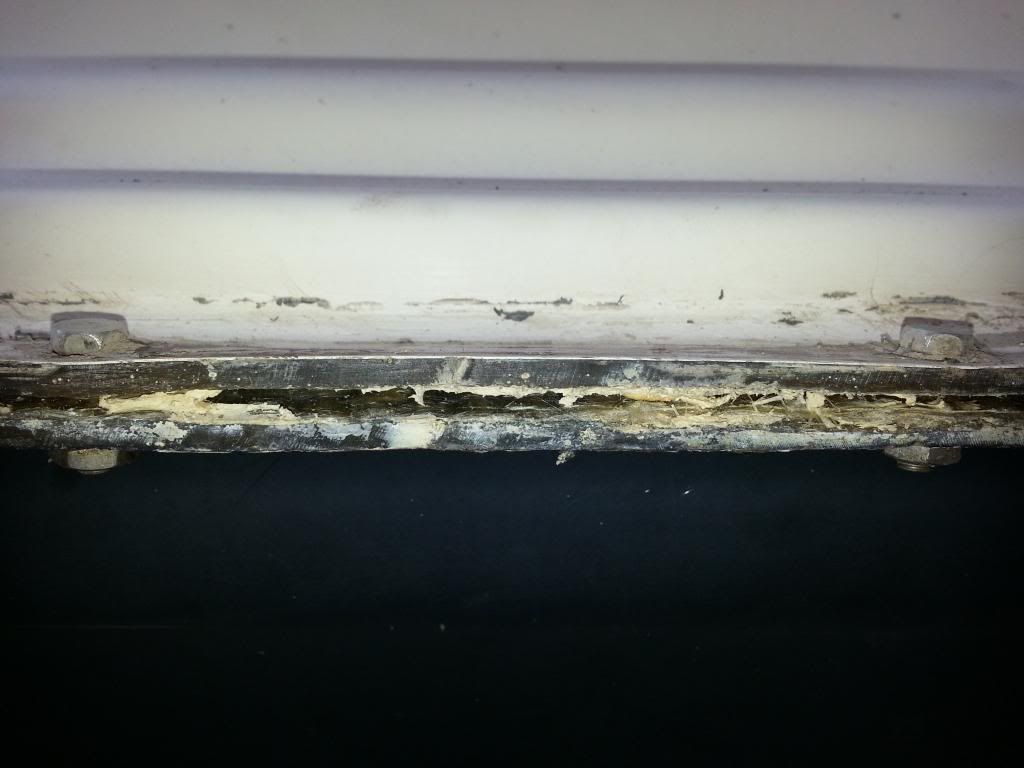

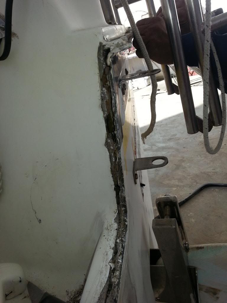

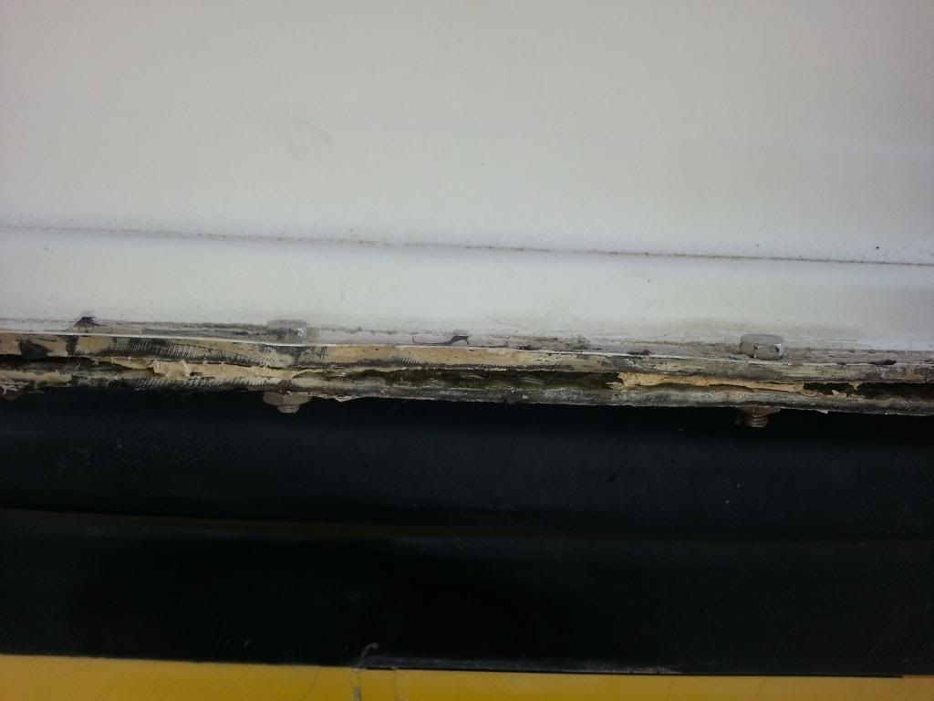

Finally I re sealed the hull and deck joinet it was 3 days work... after washing my MiniMac I found out I did not solved any issue... it cMe to my mind what Albert Fischer (Madelon) said.
I examined that with garden hose and flash light... yes it is the problem and it is the source of water in the bilges... never mind at least am happy that I did it

AbuSiyam
- Posts: 11
- Joined: Sun Jan 05, 2014 12:46 am
- Location: Kingdom Of Bahrain
Re: MacGregor 26 (1993)
here are the photos of repairing the hull & Deck joint and what was under the rubber reail
