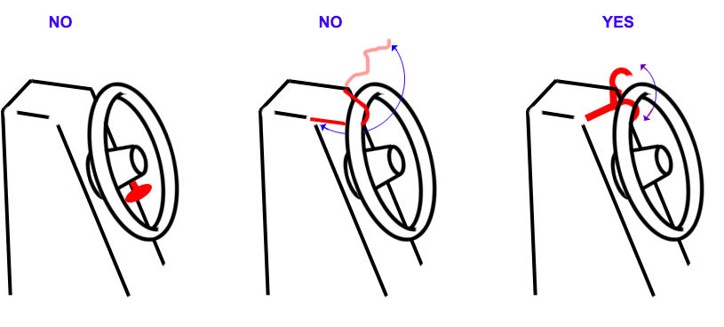

This is so frustrating. The number one feature I need for my single-handing is a wheel tamer. But try as I might I have been unable to build one that works.
All I want is something that will hold the wheel in place so I can go forward for a moment. An auto-pilot is way overkill.
I do NOT want a knob on the wheel axis. It's got to be operable from anywhere within reach of the pedestal, so I don't plan on reaching down under or through the wheel to turn a knob.
I want a stopper at the top of the wheel, where it can easily be set or released with just a flick. Currently, I have a 6" bungie from the pedestal that I have to wrap around the wheel rim. Very awkward to set or release in a hurry because I have to thread it through the wheel and hook it on.
The piece I'm really having trouble with is the part that actually grabs the wheel. It's got to have a firm grip and prevent the wheel from moving laterally. The simple plastic clip I tried wasn't enough.

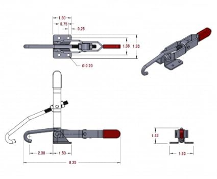

What about some type of toggle clamp?
http://www.amazon.com/LT-451-Toggle-Hol ... 73&sr=1-24
Re: wheel tamer
I was thinking the same basic mechanism. Maybe made from SS or even Starboard, with a synthetic rubber 'grip' area inside the hook. Flip the hook over the wheel, lock the handle down (preadjusted to just hold the wheel without ripping it out of the helm), go forward. Takes a second or two. But might take several iterations of construction to make so it works as intended.

Seapup wrote:What about some type of toggle clamp?
I like this. I have a feeling though that it won't fit in the space without interfering with anything on top of the pedestal, such as my GPS.

So I'm making a little rubber clamp on a hinge that folds upward and clamps on the inner rim. Unfortunately, the distance from pedestal-top to wheel-rim is longer than the distance from pedestal top to wheel-axle, so the arm doesn't fit well in the stowed position. :(
I've discovered something frustrating. I'm trying to attach the hinge under the top edge of my pedestal, where there is a lip (previous mod). I cannot get at this lip without removing the wheel. So:
1] At 3/4", the wheel bolt is larger than both my - and almost anyone else's - socket set.
2] Even with the bolt off, the wheel doesn't come off. I think I might need a puller:
