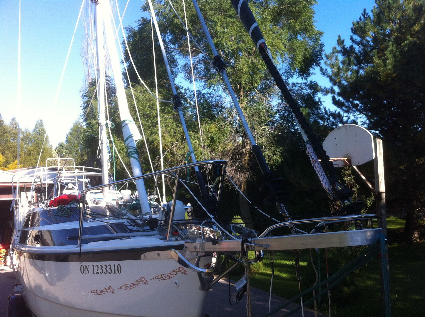

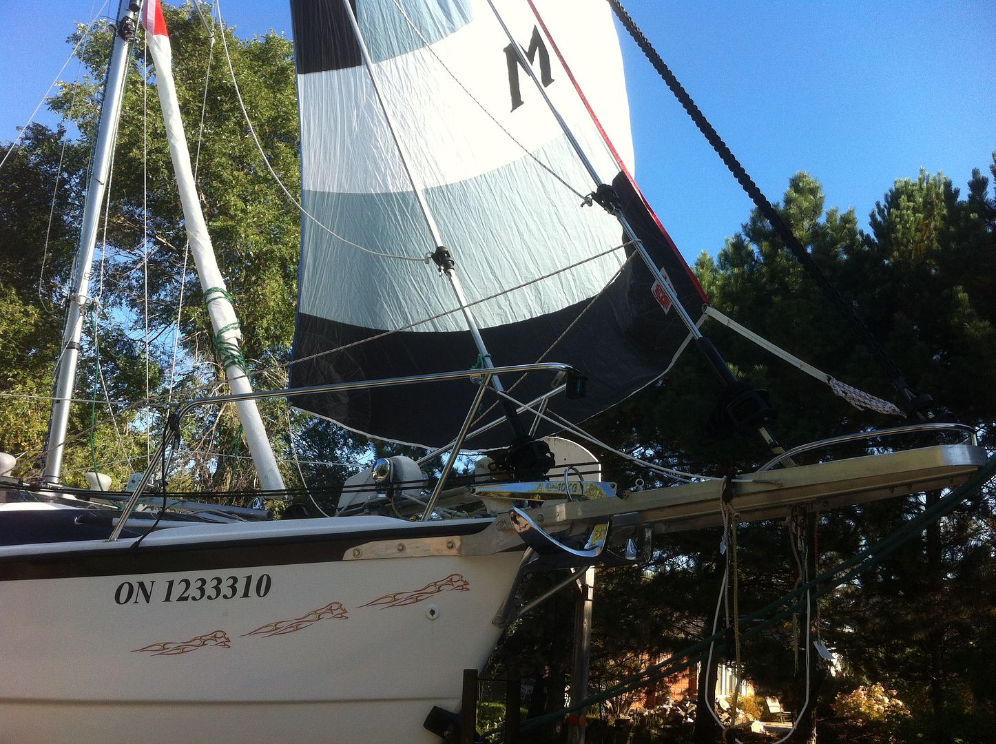

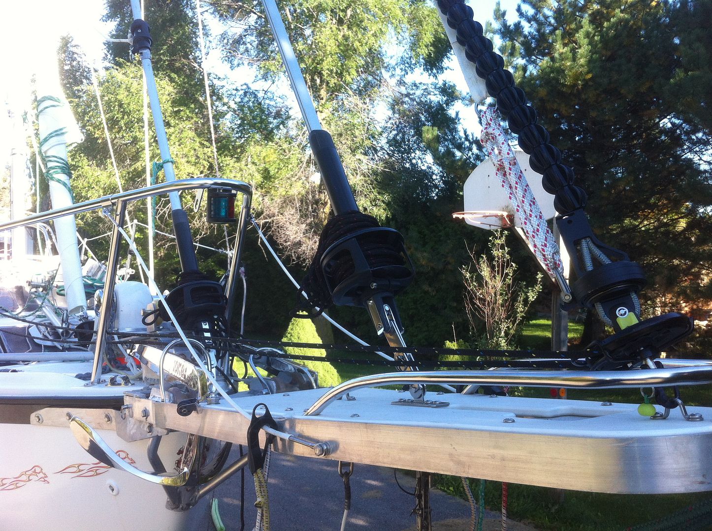

That is one impressive looking bowsprit. How does it effect your sailing? What kinds of winds does your M now most favor? Can you run appreciably faster in lighter winds or is it better suited for 15+ winds? Great job.

Bet it would be real interesting, if in a good blow, someone uncleated all four furler lines (say if you use clutches, this could happen). Would the sails nestle nicely together or would they be flapping all over the place? If it were me, it would be the latter.

He does not use all the sails at the same time. You need to look at the way it's rigged - in particular look at that fore stay that connects about midway between his bow and the mast - that one is for a storm sail. If I was not a trailer boater I would install one of those myself. It's a great place to fly a storm jib because it moves the pressure closer to the middle of the boat in high winds. It's a much more effective way to use your storm jib instead of flying it off your main fore-stay. He is going to see a lot more nasty wind conditions up there in Canada than i will ever see down here so it's even more important on that boat than it would be on mine.
Head-sails turn the boat away from the wind. He surely will not have a lot of problems with rounding up when those head-sails are deployed! (And don't call him surely).

the storm & drifter furlers can be coiled up & thrown in a bag with sails still attached :arrow: :idea:
