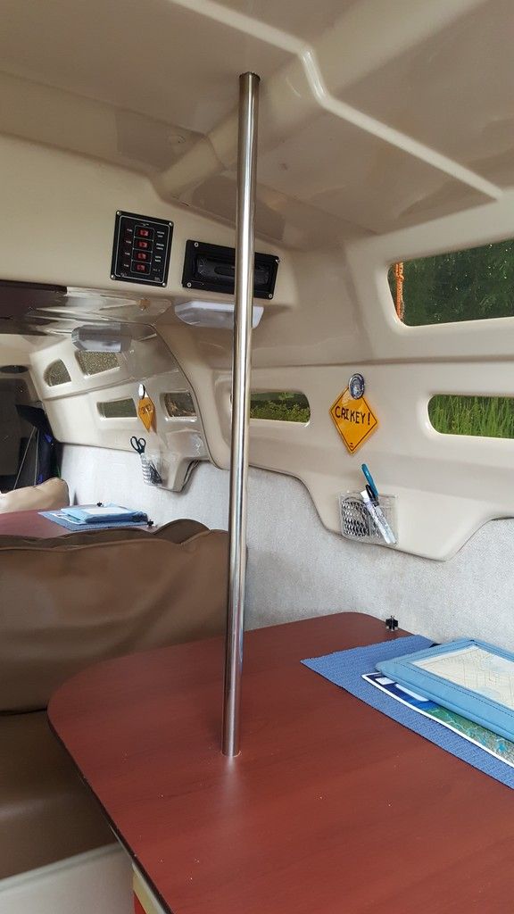

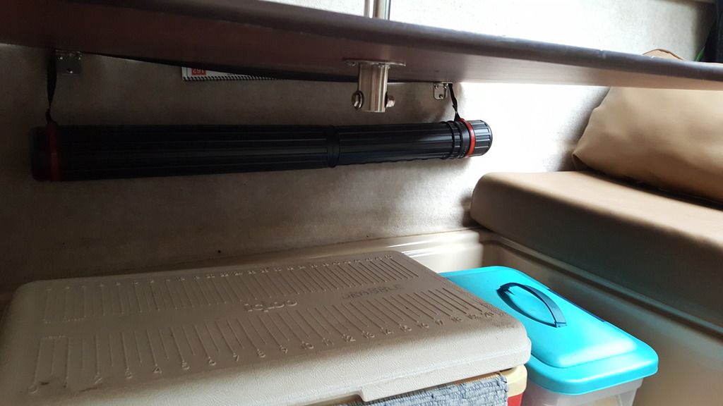

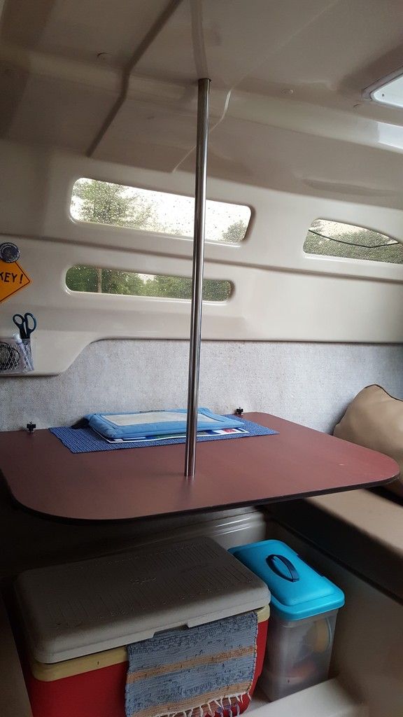

For a number of years now we've been putting our secondary cold storage (read cooler and ice packs) underneath the dining table on our :macm: and have cursed every time we maneuvered around the factory leg to access it!
I thought up this mod to not only get around that, but to provide a grab-rail for my Admiral (and others) who needed it, and also averting breaking the table when things went wrong. The only thing I did was to drill a hole (plug-able) through the surface and thusly re-locating the original leg position somewhat forward by six inches or so.
Under clearance is in a happy place:
http://i1121.photobucket.com/albums/l52 ... hsflns.jpg
I used my redundant rudder link-bar cut down and fitted with a threaded slug) as the grab rail.
http://i1121.photobucket.com/albums/l52 ... jzhrwv.jpg
http://i1121.photobucket.com/albums/l52 ... gkkoog.jpg

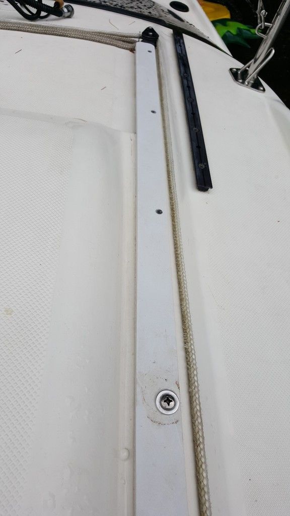

Attached to an upsized SS machine screw located in the sliding cabin hatch topside rail
http://i1121.photobucket.com/albums/l52 ... scigex.jpg
The nut attaching the original screw will be located behind the removable plug in the ceiling above the table. Make sure you use washers and nylocks on both sides, as well as some 3M type compound to seal things up again,
This is much more robust than the factory effort and the table is not being prevented from its alternate purpose of turning into an extra bed.

Very interesting mod , what do u do with the support bar when the table is used as a bunk ?
Crikey
Posts: 1833
Re: Table Mod
Post by Crikey »
The bar just unscrews from the upper bolt which stays put with a nylock and large washer hidden behind the interior liner. The original smaller bolt had a second nylock concealed under the actual hatch rail which I dispensed with. It bamboozled me for a while when I2 couldn't push it out to replace with the bigger (1/4") bolt. I was going to use some other pipe but the rudder link bar was solid and nicely chromed as well as SS and I had no further use for it after my hydraulic installation.

I could probably hang on it if I wanted to BOAT. The table is now also much stronger!
Re: Table Mod
The compression post is one of the reasons the table makes the best berth in the :macx: . It's just about as convenient as a grab bar as a post at the midpoint of the table, since it's just about at the midpoint of the table, but outside the perimeter.
