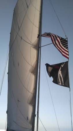

I fly a few flags from the spreaders but this does add to the pain of rigging the boat. I also have a fishing pole holder on to of the
mast support and it is very easy to insert a 3 0r 4 foot long dowel with a flag attached.

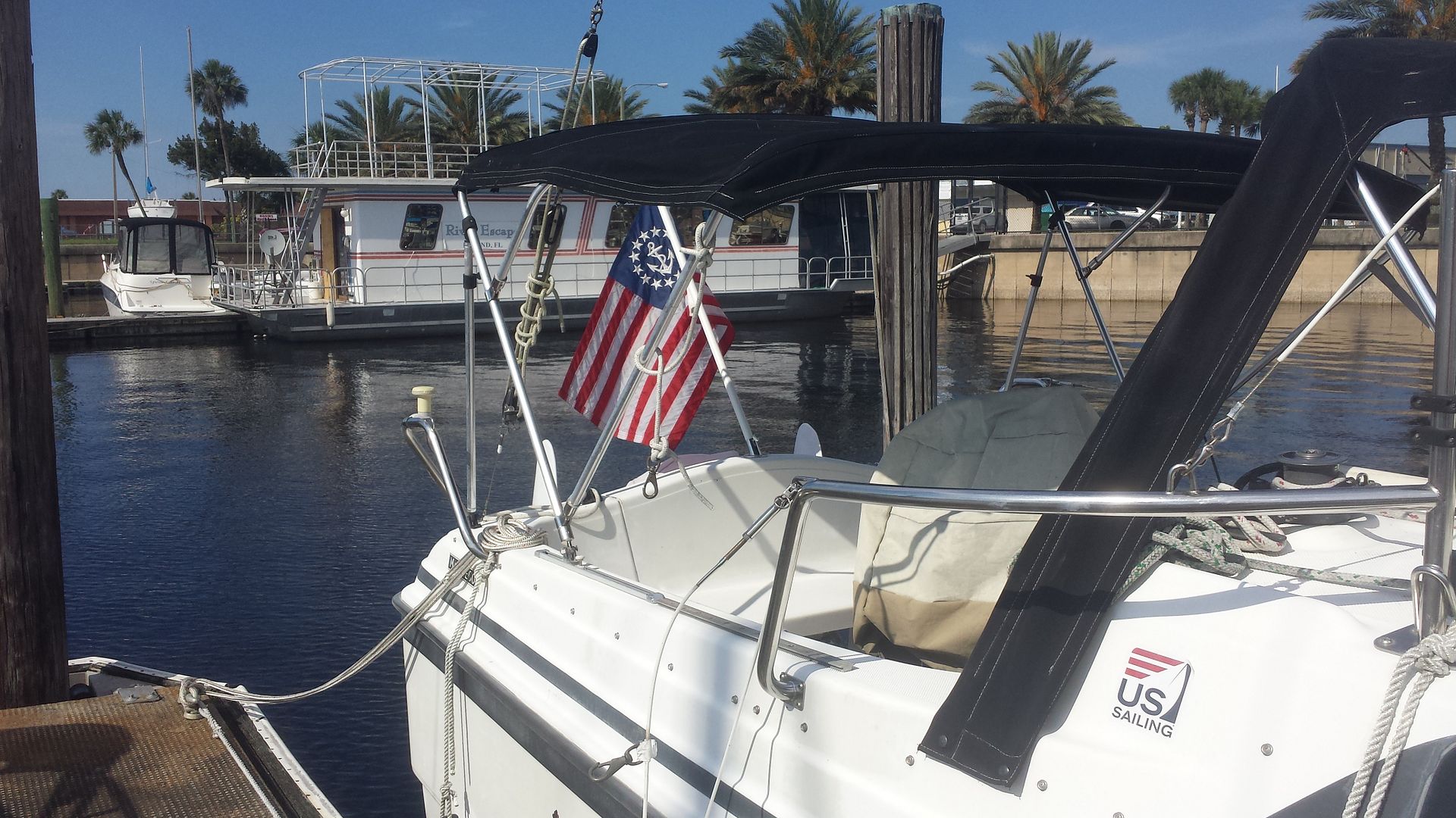

I'll just post pics of my two locations for the national ensign. One for motoring that is easily mounted in a fitting on the stern and taken in when tied up in the marina in the slip:

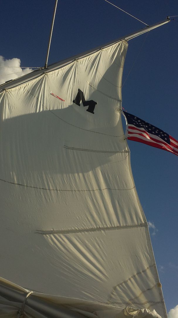

And another position when sailing on the leech of the sail where it stays attached at all times, folded into the sail when furled:
I had Doyle Sails install two reinforced grommets in the leech to handle the size ensign I wanted to fly. Both positions are relatively hassle free. The ensign on the leech requires checking occasionally for wear on the bindings that tie it to the grommets, but that is all.

I think maybe I'll go with this option.Herschel wrote: And another position when sailing on the leech of the sail where it stays attached at all times, folded into the sail when furled:
I'll wait and attach grommets for two burgees over the dry season.

One added benefit to this use of the flag is that it becomes a very nice tell tale. If that main isn't drawing well going to windward, your flag will let you know!DaveC426913 wrote:I think maybe I'll go with this option.Herschel wrote: And another position when sailing on the leech of the sail where it stays attached at all times, folded into the sail when furled:
