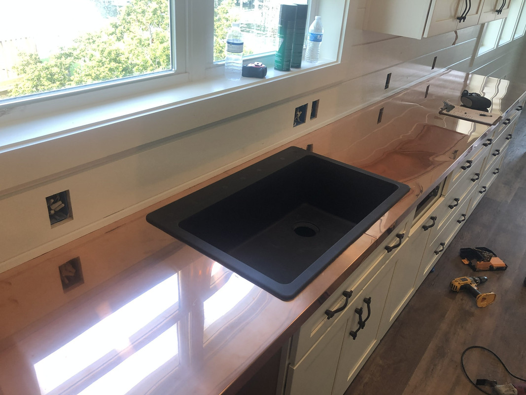

Helped a buddy bend up some copper countertops yesterday. Mentioned here just in case anyone wanted to do something really different in their galley. My aluminum brake bent the copper roofing sheets easily. Harder to cut and much harder to manage without kinking than aluminum though. We could have used at least one more set of hands. It is a unique look and should patina into something remarkable.
A couple of honey-do days, then I'm back on my galley...
