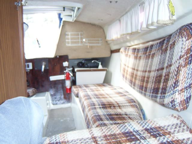

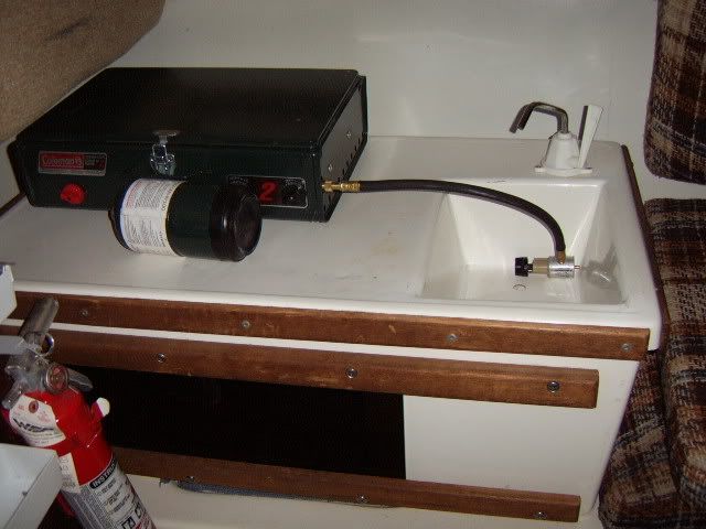

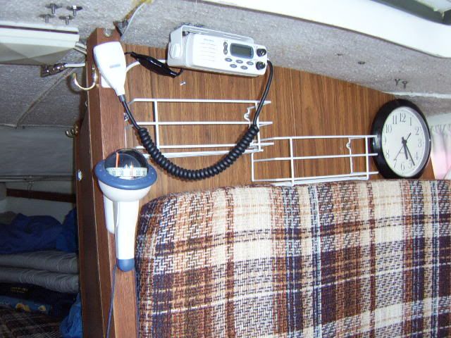

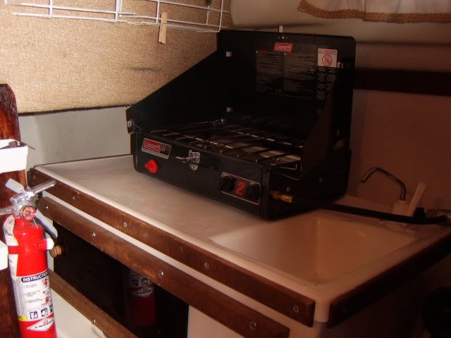

Greg,
Here are some photos on my Photobucket site:
http://i5.photobucket.com/albums/y163/b ... OMPASS.jpg
http://i5.photobucket.com/albums/y163/b ... VEOPEN.jpg
http://i5.photobucket.com/albums/y163/b ... YSTOVE.jpg
http://i5.photobucket.com/albums/y163/b ... EDAWAY.jpg
I did a bit of work after getting my boat. The liner (which is part of the boat's structure) was warped at certain spots. I reinforced it with plywood. Make sure you rest the keel on the trailer or there will be a lot of excess strain on the boat. I also replaced the piece of wood under the companionway (where the keel winch is). This is also an important part of the boat's structure so make sure it's in good shape and for sure don't remove it like some people have. One of the easier and more useful mods was the addition of a lever to the forestay. That way the forestay can be pinned whiled it's loose and then tightened with the lever.
My wife, friends and I got a lot of enjoyment out of our Mac 25. Hope you have fun with yours.
