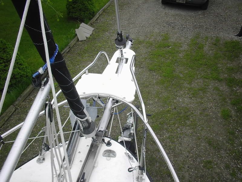

The original owner i believe used this bow anchor locking brkt on the bow for a second forstay on my boat its on the s/b side of the bowsprit mounting brkt just behind the light plug in this pic I've never used it myself but left it on when I installed my bowsprit figured it will come in handy one day .
I think it was used to fly the jib wing on wing with the genny & mainsail

How would you attach a second forestay on the second hole when you have the furling drup to contend with?

here's what's in the mods section. the 2nd forestay/furler attaches to the bow pulpit.
looks like he added a turnbuckle from the pulpit to the deck.
i currently have a 2nd halyard fastened in this manner. i use it in lieu of the mast raising system and to provide insurance for furler failure and mast fall while motoring at 20mph.

It attaches to the extra achor safety locking devise on the s/b side has about 6" clearance from the furler drum
