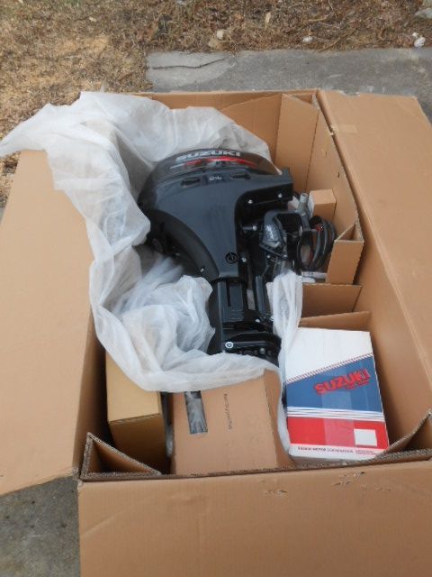

I have about 60 hours on it in a month now
Break in, shake down and a trip added them up quickly.
Fuel Use - Last week did about 145 miles motoring with the sailing is subtracted out. It worked out to about 30 hours of motoring and used 10 gallons.
14.5MPG and 1/3 gph.
About 4 hours were wide open, most around 5 mph half throttle, and a few hours slow timing bridges/locks. The 90 averaged about 1gph @ 6mph 2k rpm. Opened up it drained 6 gal in 45 min at about 3mpg. I did the same stretch of ICW last spring, but 40 miles less, and used a little over 20 gal, so am happy with the fuel use. I shouldn’t need to take jerry cans on trips anymore.

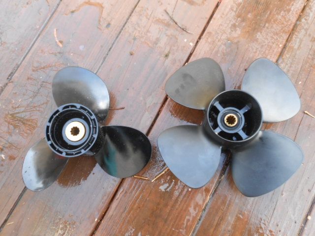

I have used 6 props on it now. Basically neither 4 blade worked, they both slipped and ventilated trying to get over 6.5mph when the boat is plowing. The 3 blades are predictable, the 10” pitch stops at 7mph/4k and the 7” pitch 8mph/5300rpm. The 10 pitch reaches 6mph at 2500 vs 3000 rpm so I swapped back to it for the second half of the trip since I was in no hurry.
Overall it took some mental adjustment that I couldn’t just hit the throttle when I was getting tired of motoring down the ICW. I am looking at it as a 1 speed boat …sailing whether there is wind or not…and that works for me. It took longer days with it on the same trip, but resulted in more stops and had a more relaxed trip overall. I was able to practice maneuvering it in a lot of situations through locks, bridges & stops last week. As long as you don’t come in too hot its nice and relaxed with good control. I took some pride when next to the other transients and delivery crews doing the same maneuvers (in larger boats of course) with a less fuss than them.
I am glad I had the 90 and enjoyed it thoroughly. Would I buy it over or trade for a new 90, absolutely,
will I trade back up, probably not.
The little motor does what I like to do.
