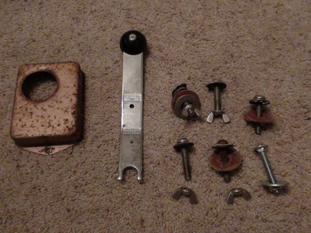

Took a photo of some hardware that came with the boat. The SS bolts / worn out washers must go with the top. Rusty winch cover and handle to the two winches in the cockpit. Will replace them in the near future.

We seem to have the same type of hardware.
Except, mine is rusted in slightly different places.
